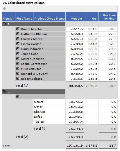

Regarding the use of extra columns and divide by zero:
Did you use the Total (Formula style) of +Columns?
When using this type, Dynamic AI should return '0' instead of an error as shown in the below example, where I removed the Condition set on [Version] and grouped by version as first row grouper.
- Divide by zero in a Total (Formual) type of +Column
- Clipboard01.jpg (42.7 KiB) Viewed 42821 times
As you see the result is '0' where [Hrs] are null or 0.
If you still got trouble with this, you are more than welcome to send me screenshots showing the issues.
