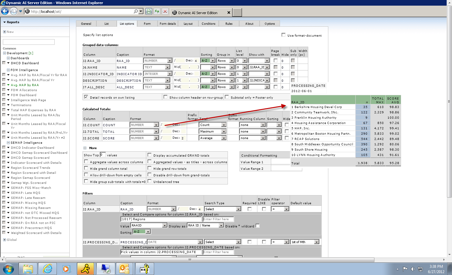

Postby cjbates » Wed Jun 27, 2012 8:42 pm
See attached - the Captions that I have indicated on the List Options tabs for Calculated total columns are not being displayed based on my settings. Not sure where this information is coming from?

If you look at my screen shot, that calculated total column does have a caption indicated as "Count" but it is not being used on the graph...Is there somewhere else I need to update this?

The graph doesn't show in your screen shot.
But notice that the count column on your report is simply 'n'. This is automated behavior on a count column absent your providing an explicit name. Try changing the caption on the J2.Count total to something more descriptive like "Trns. Count" or "Unit Cnt." etc. What kind of chart are you using. It looks to me that you have an order of magnitude difference among you totals. The chart is going to scale to support the highest values -- so the lowest ones maybe difficult to see without using a "multple y axis" type of chart.

The caption for J2 is set up as "Count" but the report column is displayed as "n". You can see this in my screen shot....
