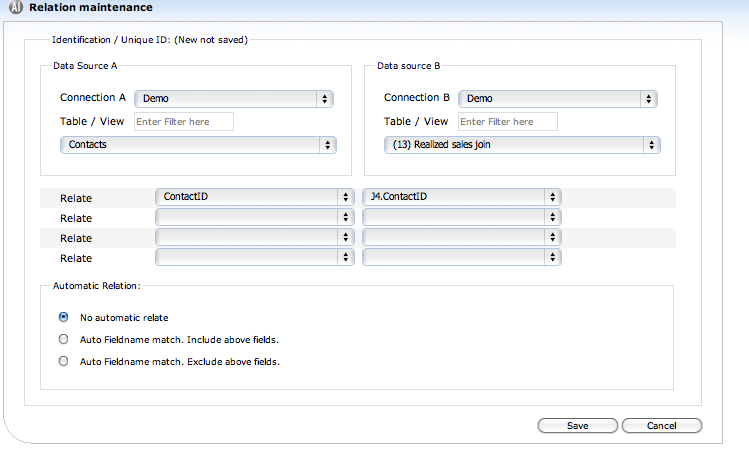

You are right about the need to setup a relation between the datasources. Once a relation is set, every report based on one of the sources can be set to drill to reports based on the other.
Below is an example that I just created based on the Dynamic AI Demo:
First I set up the relation:
Relation
Screen shot 2010-01-12 at 9.56.08 AM.png (56.23 KiB) Viewed 8550 times

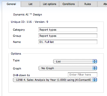

In a report that is based on one the sources in the relation (in this case a contact list):
Report ID 116 in the Dynamic Demo
Screen shot 2010-01-12 at 9.57.58 AM.png (8.04 KiB) Viewed 8550 times

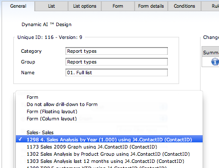

Drill down to is changed to the relevant related report:
Change drill down behavior
Screen shot 2010-01-12 at 9.59.16 AM.png (44.24 KiB) Viewed 8550 times

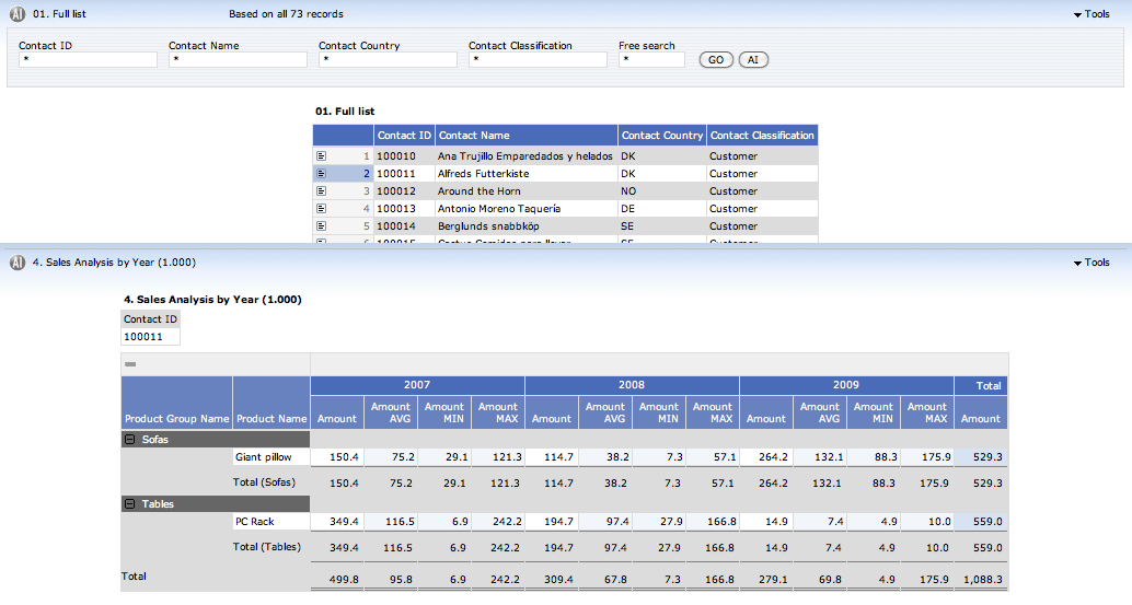

When report is executed related drill down will be show as
Related drill down
Screen shot 2010-01-12 at 10.00.00 AM.png (80.01 KiB) Viewed 8550 times
This example shows a simple related drill between a list and a pivot table with a fixed relation point (Contact ID).
In case that column names are identical in the two datasources Dynamic AI also offers automatic identification or the related drill down based on the users "click".

Postby Bob Cergol » Tue Jan 12, 2010 3:01 pm
Thanks Mikkel,
I understood correctly. I just didn't do it correctly. I was using an actual table instead of my DAI view for the table in my relation. A report now appears in the available drill-down list based on the relation.
