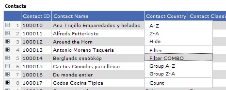

Can you point me in the direction of defining a drop-down filter on "CSR". What about a case where there is no table of valid values?
Re: How to create a drop down list on filter?
Postby Carsten Sørensen » Wed Dec 23, 2009 8:39 pm
You can define the drop down on the List options page. You can choose between SELECT, COMPARE and multiple SELECT and multiple COMPARE in the search type.
The default is that it will use the CSR column itself on the listing to generate the drop-down - however you can redirect it to pick values from another report specifying the report + display and data values.
When no entries - it will allow you to use * for selecting all entries.

Postby Carsten Sørensen » Wed Dec 23, 2009 10:27 pm
actually... I completely forgotten - there is an even simpler way :-)
