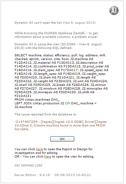

Postby Carsten Sørensen » Fri Aug 06, 2010 3:17 pm
I have fixed the issue - created a new specific INGRES type connection.
You can get the join-builder views to work if you use e.g. the Informix Connection type in Dynamic AI.
The ODBC specific one will strip the prefixes that causes problems for INGRES, the Informix type doesn't.
The problem is now that the Informix connection type doesn't use the specific MOVE method that we created for INGRES compatibility... but you can test the JOINBUILDER... therefore I created the new INGRES type.
The funny thing is that I can't reproduce the crash at the moment... at least not with your testdb..
I apologize for not catching the error better in Dynamic AI! It is always an issue to get the right balance of things in the error reporting - and at which level we catch it.

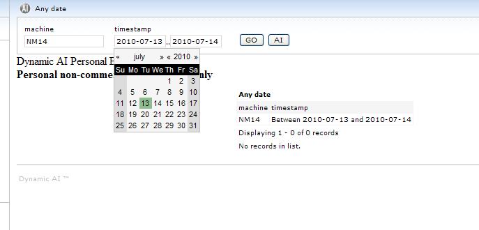

I've found that there is a formatting error in the last version you prepared, when entering dates from a calendar selection. From the odbc log, the formatted string looks like it is a little confused:
Code: Select all
!IIapi_query: queryText = Select count(*) AS DAICountSta FROM catdba.log DAI_ WHERE ((DAI_.machine='NM14') AND ((DAI_.timestamp Between '7/13-2010' AND '7/14-2010'))) AND (mod(date_part('min', timestamp),5) = 0) for readonly
!DBMS Error: (0x000010CE) '7/14-2010' is not a valid date/time value.
The above example is for selecting run time logging data between 13-Jul-2010 and 14-Jul-2010. It looks like it is being transformed to US mm/dd/yyyy format, but is actually coming out mm/dd-yyyy. I'm wondering if this is just an error in the 'Ingres special' version you prepared? If so, and it can easily be corrected, it would be good if the final format used could be one that is not easily misinterpreted.
My first preference would definitely be for dd-mmm-yyyy (14-Jul-2010) as it is unambiguous and is recognised by all of the database releases I'm using, regardless of the configured display format for the database. I believe this format would suit any potential Ingres users. Next for my purposes would be what Ingres describes as MULTINATIONAL dd/mm/yyyy (14/07/2010) which is also recognised by all of my database configurations .... but which is unlikely to suit all Ingres users. The yyyy-mm-dd format, which would seem quite logical, is only correctly recognised by my most recent installation.
Trust me to find another problem!! A screen image of the date selection arrangement follows.
Re: Unable to use Views and Joins
Postby Carsten Sørensen » Mon Aug 16, 2010 7:24 am
Thanks for reporting this.
The mm/dd-yyyy format - should be - SQL ANSI standard or something like that... at least that has been working for other ODBC databases since long time. Whether that is a standard or not - we apparently need special date handling for Ingres. I think it should be irrelevant to the end-users which format we use in the SQL as long as the display on the reports and in filters is correct or?
I will investigate implementation of a special Ingres date handling.

I don't have a response from the Ingres forum yet ... but it turns out I don't need to wait for one!
In the back of my mind I had a memory that my 'problem' report used to work ok using the generic ODBC driver. I've now tested that and found it is the case. This suggests that the unusual mm/dd-yyyy format in your current Ingres driver was probably picked up during construction.
The other REALLY good news for me, is that I've also tested the generic ODBC option doing date selection against my earlier Ingres releases ... and they all work fine!! I've also checked the Ingres ODBC traces and found that the sql date string shown in the trace is constructed by Ingres to suit the target server version.
So, this means that in order to correct the current problem with your Ingres driver, the current date string formatting code just needs to be replaced by whatever is being done within the generic ODBC option. My expectation is that it will be providing an ANSI compliant string which is being adjusted as appropriate by the Ingres/NET ODBC driver to suit the target server.
Hope I've explained this all clearly enough, and that this means the Ingres connection definition can be corrected fairly easily :D
Postby Carsten Sørensen » Tue Aug 17, 2010 1:24 pm
Thanks for the feedback!
I can confirm your observations regarding the date conditions working fine with the generic ODBC connection type!
I will adjust the INGRES connection type in Dynamic AI to use the generic ODBC date handling.
Will let you know when you can pick-up the modified version!

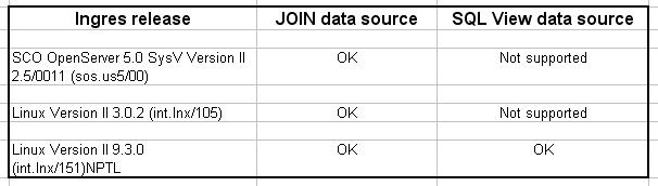

Just thought I'd post a brief update on my Dynamic Join versus Dynamic SQL situation. The main short coming I've found from Dynamic SQL not being available on my earlier releases, is that the complexity of the data behind the data source is limited, as you're undoubtedly aware.
In particular, some of my data sources would ideally make use of 'union' select statements. These can be easily constructed within Dynamic SQL, but I can't see how this can be achieved using Dynamic Joins. If there is a trick for doing this please let me know! Of course, with some restrictions, appropriate views can be constructed within the database ... but is a nuisance.
Anyway, all of the above really gives me incentive to upgrade the associated systems! Unfortunately these upgrades won't happen overnight ...
Hope you've been getting more sleep since my last post :)
Postby Carsten Sørensen » Tue Sep 07, 2010 3:18 pm
A union builder has been discussed a few times - we'll make it sometime!
The issue that it would need to address in your case however would be that it can't handle the union'ed data-sources as 1 source (encapsulated in a surrounding SELECT) - as that is the limitation of the older driver. I.e. filters and conditions would have to be "injected" into each step of the union - and eventually each union data-source could have different column names - all in all - something that a union builder could handle but we haven't got it yet!
