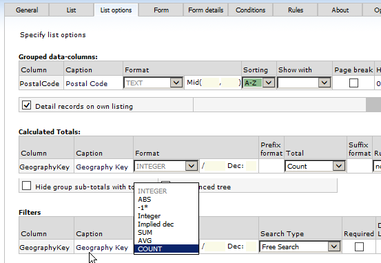

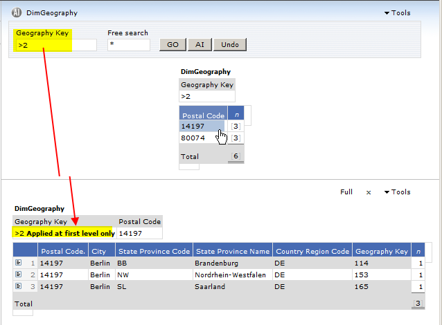

To output only duplicates you could:
a) make a grouping on the column you want to test for duplicates
b) make a filter and use the "count" function -- yes Dynamic AI will let you do that but it requires a grouping and the filter will only apply at the first group level.
Examples below illustrate using Adventure Works 2008 Data Warehouse database and the dimGeography table. I grouped on PostalCode. I'm looking for postal codes with at least 3 "duplicates". By making a count type filter I can then show only those groupers where the count is greater than # -- in your case that would be greater than 1.
