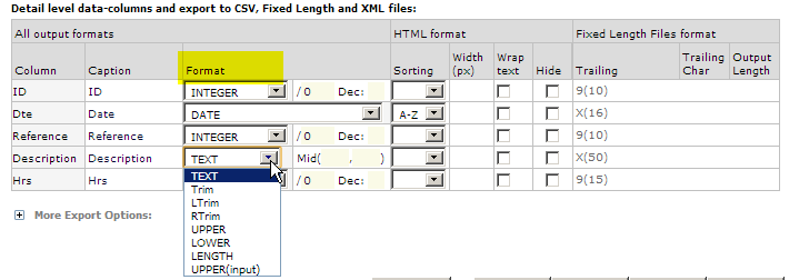

I have to set the record straight. I said I didn't know of any "trim" commands on the list options tab page.
It's been so long since I used them I forgot about them. There is a drop-down of formatting options that presents different options based on the data type of the column. On text columns trim and others are available.
Re: trim
Postby Carsten Sørensen » Wed Jan 16, 2013 5:13 pm
The "mid" command on list options can also be used as a Right (type R) or as a Left
The option is explained in the title when hovering the mouse over the Mid input fields
