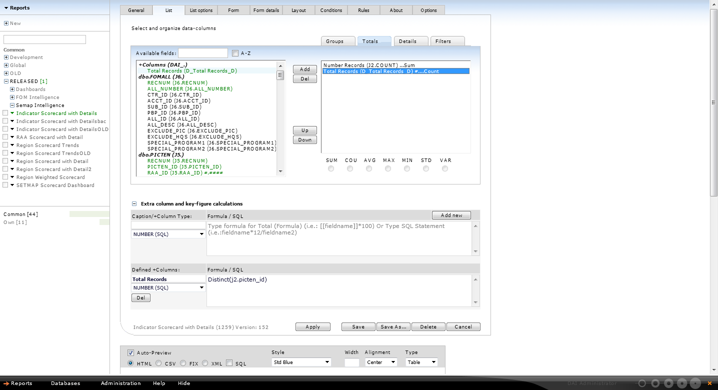

I am trying to get a distinct count of a field and use it in the Totals tab in my report. When I drill down to the details section I am getting:
Dynamic AI can't open the list Indicator Scorecard with Details:
While connecting to the SQL Server database (trackersqlbuildsql), a problem arose.
Dynamic AI is using the view (ID:1160 - SEMAPI to PICWEB Final) with the following SQL defined:
SELECT *
FROM dbo.SEMAPX DAI_
LEFT JOIN dbo.SEMAPXD J2 ON DAI_.INDICATOR_ID = J2.INDICATOR_ID AND DAI_.PROCESSING_DATE = J2.PROCESSING_DATE AND DAI_.RAA_ID = J2.RAA_ID
LEFT JOIN dbo.SEMAPI J3 ON DAI_.INDICATOR_ID = J3.INDICATOR_ID
LEFT JOIN dbo.S8DHRAA J4 ON DAI_.RAA_ID = J4.RAAID
LEFT JOIN dbo.PICTEN J5 ON J2.PICTEN_ID = J5.PICTEN_ID
LEFT JOIN dbo.FOMALL J6 ON J5.ALL_ID = J6.ALL_ID
The issue reported from the database is:
Incorrect syntax near the keyword Distinct.
How can I get a Distinct Count of something?

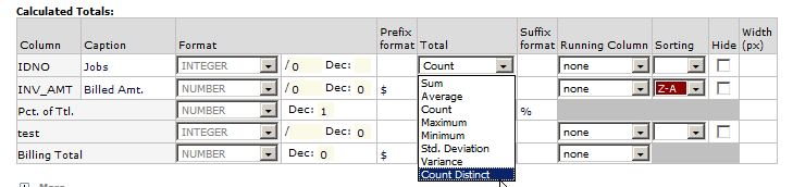

Cynthia,
Instead of using Distinct() in your +column formula -- try setting the total type on the total column involved.

Postby cjbates » Mon Dec 17, 2012 4:52 pm
Duhh...sorry I didnt see that as an option in the pull down. Works great!

Postby Bob Cergol » Mon Dec 17, 2012 5:47 pm
Don't feel bad. -- When I first started using Dynamic AI I didn't notice that option either, since all but that one total type are defined as radio button on the list / totals tab where you can set the total type -- except for "count distinct".
