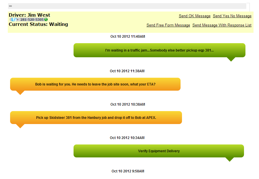

I have a DAI report that I want to change the width. Basically I want to shrink it (the grid and/or the cells) so that I can see 2 or three of these reports when I'm creating a dashboard. Each 'bubble' is just a data element that I put style sheets against so they are really just data elements in the grid. I've tried hacking into the css behind the scenes but I'm not getting the right object. Is there a way to do that?
Also, when these columns shrink does DAI wrap the contents of the cells?

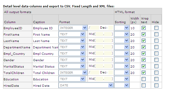

There is an option to set the TABLE element WIDTH on the LIST tab (next to Auto-preview) - and it will apply - however I think there is too many other CSS attributes that kicks in nowadays for this to have impact.
If you combine with detail column level WIDTH and allowing WRAP (see attached) then I can get my table shrinked to its content.
Please let me know whether you can get that to work?
