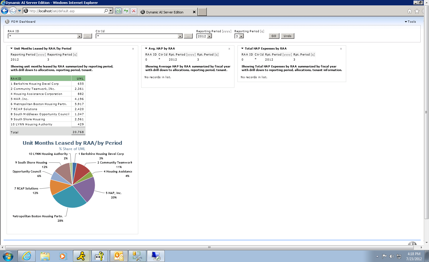

New problem on one of my dashboard packages. I have 3 reports that use the same filters, but when the dashboard loads, only the first report "runs". The dafault values are set correctly, but the user must click the Go button before the second and third reports display data. Is there some setting in the report itself that I need to check to have it automatically run?
They run fine when run directly from the report.

Today I looked at this dashboard and all 3 reports were built on the same data source. The filters were defined the same in all three reports, and all 3 reports had filter preference scope set to "local".
When running the dashboard the 2nd two reports show a filter value of 0 for RAA ID (see screenshot in original message), whereas the 1st report is show information for an actual value on that filter but does not show the filter in the report itself as do the others.(???) Clicking "go" refreshes the 2nd & 3rd reports correctly. I can't see a reason for the problem!
