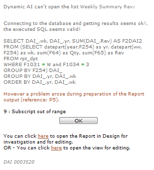

Postby robinsonky » Thu Mar 15, 2012 9:20 pm
Now I have my data organised for my weekly table. about two years of weekly info.
Trying to find a nice graph and with a few of them I get 'subscript out of range', here's the actual error message

Postby admin » Thu Mar 15, 2012 9:35 pm
Can you post (or email or private message) a sample of your data? Might there be "strange" values in you F254 date field - sometimes there is a date like 1-1-1753 that is inserted instead of nulls. If so, Dynamic AI must be made aware of this by inserting a system parameter (Administration/System/System Parameters) add a line with
APPLICATION / ZERODATE / DATE / 1753-01-01
and Dynamic AI will treat this date as null

Postby robinsonky » Thu Mar 15, 2012 11:25 pm
Bob, this is a new and different application from the one in our xmas conversations. That one is in production.
there are no nulls or odd dates. The SQL has already rendered all dates down to a year and a week number.
Code: Select all
select  datepart(year,F254) as 'yr', datepart(ww, F254) as 'wk',  sum(F64) as 'Qty', sum(F65) as 'Rev' from rpt_dpt where F1031='W' and F1034='3' group by F254
As the error message says, the SQL executed properly, it's the conversion to a graph that blows out, and just for some formats.
