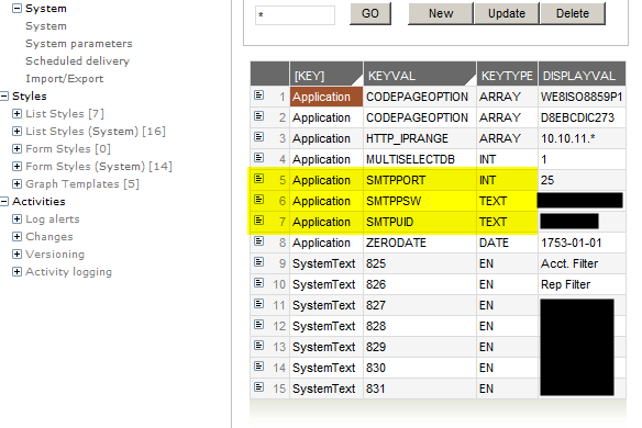

PostPosted: Tue Nov 29, 2011 10:03 pm
No, not at all. The smtp server could be a remote email server -- google smtp for that matter.
If credentials are required you set those up in System paramters
like this:
There is also an SMTPAUTH parameter in case "NTLM" is needed instead of "basic".
There is also a new paramter: SMTPUSESSL INT set to 1, in which case the port value would probably be set to 587.
