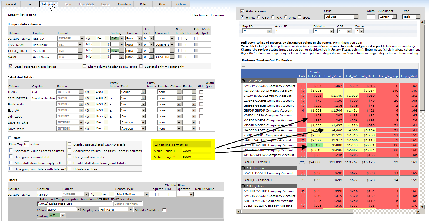

Highlights.
So now I turn over the first dashboard to the Financial Controller, and he says "Wow. Now if you can just highlight all the values over 5%"....
I've seen rumours of using css, but is there an easier way? :lol:
robinsonky
Posts: 50
Joined: Wed Oct 19, 2011 8:41 pm
Re: The Highlight of my day...
Postby Bob Cergol » Wed Nov 23, 2011 10:31 pm
Here's one way you could do this.
You could then control the actual colors in the style sheet. it''s pretty easy to do.

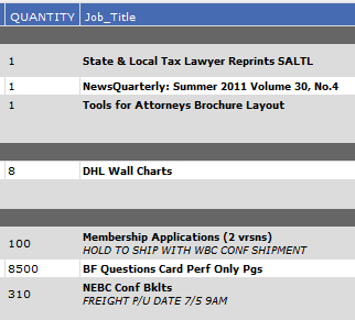

I also embed html tags in plus columns to introduce fixed or conditional formatting of specific data.
For example:
Plus column: Job Tile
'<b>' + [Title] + '</b>' + (Case When isNull(Specs_7,'') <> '' then ('<BR><I>' + Specs_7 + '</I>') else '' End) +(Case When isNull(Specs_8,'') <> '' then ('<BR><I>' + Specs_8 + '</I>') else '' End)
gives this result:
However the disadvantage is that exporting the data results in the tags getting exported as data. Also on iPads due to international character set being used the tags display instead of being rendered.

Postby robinsonky » Wed Nov 23, 2011 10:55 pm
Wow, high-speed response!
The top example is working with the Grouped Data columns, whereas I want to make my distinction based on the values in a calculated column.
I was going the CASE statement route but if I can use the normal dialogs so much the better

Postby Bob Cergol » Wed Nov 23, 2011 11:17 pm
Well my repsonse might not be so fast after I get some turkey (triptocane) in my system starting tomorrow!
The "help" link on the bottom menu bar: reports / databases / administration / help -- will take you to the full-blown, on-line manual. The documentation is pretty darn good -- but admittedly it lags behind the latest version of the product. I have some ancillary stuff I can send you if you email me directly.
If your calculated column is a total column the range coloring can be applied to it -- though you may not like having to position it where the color ranges would apply to it.
I think finer control over conditional formatting in the design interface is definitely an area for enhancement in the product.
Some of the folks at Cintac know a lot more about such tricks than I and may have some ideas for you.
