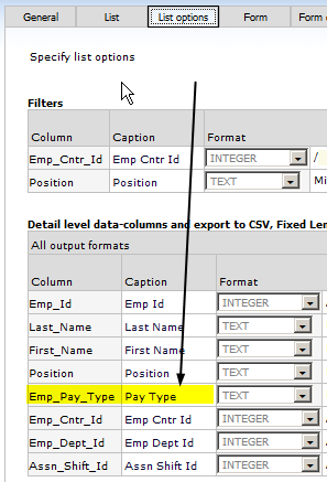

You can override the captions again in each report on the list details page.
