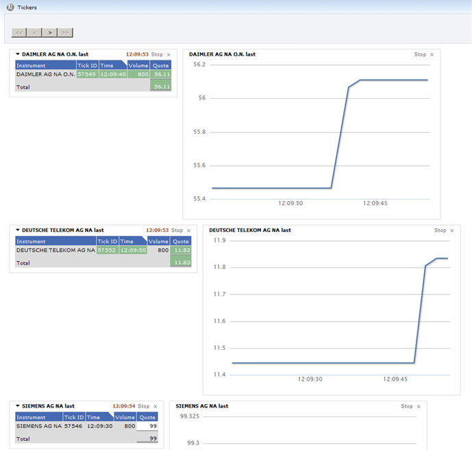

If you installed the demo site you should find a working example of a report package that displays multiple reports with graphs -- refreshing in 2 second intervals. (Stocks / Quotes / Tickers).
