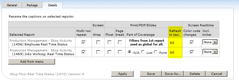

In at least one database I have seen some issues with this new package refresh feature,-- specifically, when the "color code changes" option is checked. If you have it checked, try unchecking it. Also my screen shot showed "multi-run repeat" checked, but I believe that is not related to this auto-refresh feature -- maybe uncheck that if you have it checked. Also, in my testing, I found it was possible to set the refresh time so short relative to the time required to actually run the report, that an error was triggered. Test longer refresh intevals. Lastly, if you're packages only show a graph, can you test showing both the report and the graph? (Did you check the "general alerts" log for clues?)

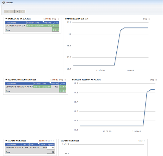

If you installed the demo site you should find a working example of a report package that displays multiple reports with graphs -- refreshing in 2 second intervals. (Stocks / Quotes / Tickers).

I just tested a package of two reports with graphs using another live production database and a refresh interval of 5 seconds. I also made sure the data changed during an interval. It all works as expected. In case I didn't mention already, or you didn't notice, I can reproduce a problem if you select "color code changes" under the "screen realtime" heading in package design details. We are looking into that issue. Make sure those are unchecked as a test. Finally, also as a test, try one of the "ticker" graph types available in the drop down in package design details.
