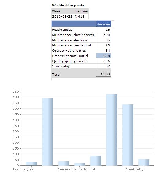

However, I haven't been able to order the report output correctly. The output I get when no sorting is attempted is shown below,
but when I attempt to sort the output appropriately

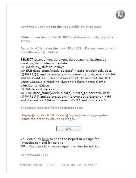

I get a database error:

Extracting from the Ingres log, trying to order within the view gives the following. The error is due to the sql subselect structure. When using the subselect structure, Ingres requires 'order by' to be outside the subselect.

!DBMS Error: (0x000009C5) line 21, Syntax error on 'order'. The correct syntax is:
SELECT [ALL|DISTINCT] target_list
FROM table(s)
[WHERE search_cond]
[GROUP BY col(s)]
[HAVING search_cond]
[UNION subselect]
[ORDER BY col(s)]

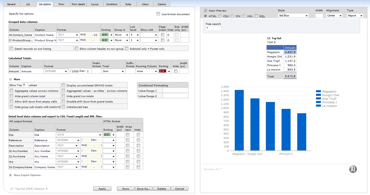

Did you try to create the list as a top list? if not please try to set a number in the "show top [ ] Values" on the list options tab.
Top List Definition
Screen shot 2010-09-22 at 9.13.02 AM.png (166.21 KiB) Viewed 20928 times

I didn't construct the report as a 'top list', and I will try that in the morning, but I'm pretty confident the problem will remain. In the example you've shown the data still requires sorting and its the way DAI is building the sql order statement, not the underlying structure, which is causing the error.

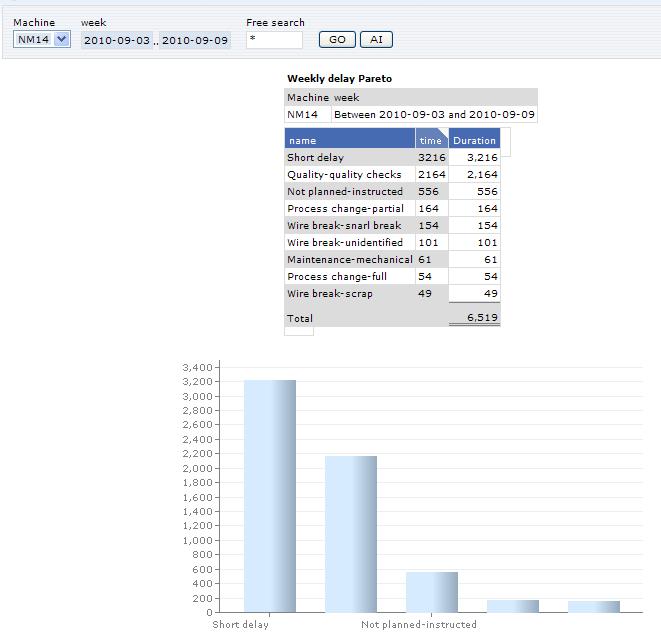

I should add that I know I can also work around the problem, in a fashion, by using 'between' date selection and a direct database view, as shown below. The problem with this approach, from a design perspective, is that it does not allow the report to function as intended within a dashboard that was to contain a mix of single date and week based reports, all driven from a single date picker.

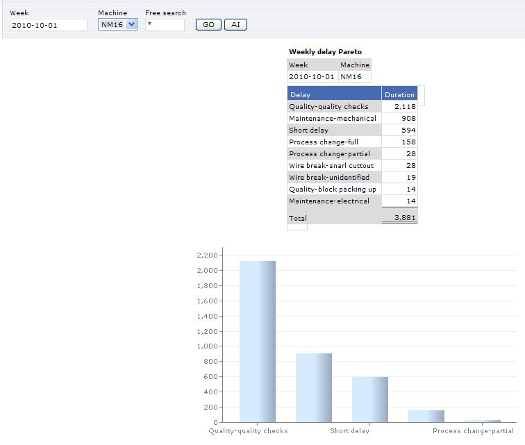

Postby shearerg » Fri Oct 01, 2010 2:39 am
I feel somewhat embarrassed right now as, although the issue described earlier still exists, I have been able to achieve the outcome I was after by using a different view definition. I'm embarrassed because until this morning I was confident I'd tested this view unsuccessfully ... but apparently that wasn't the case, as it is now sorting as required.
So .... now I'm wondering if there is really a problem at all ... perhaps I was previously just using an inappropriate technique to produce the report I was after. Either way, don't put any effort into checking the DAI Ingres interface in the short term, as I can now produce the Pareto style presentation that had been requested!
