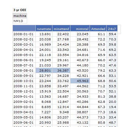

I have a report which appears as below:

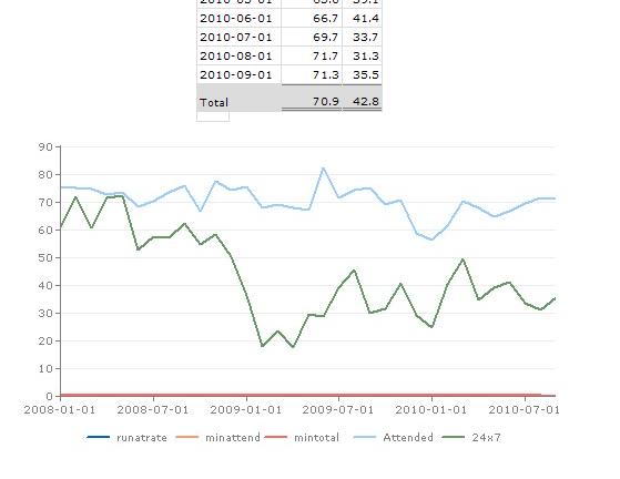

The only columns of interest are 'Attended' and '24x7'. Columns 'runatrate', 'minattend' and 'mintotal' are only required to produce the 'Attended' and '24x7' calculated columns. However, I'm unable to produce a graph which contains the two columns of interest. Even though I generally hide the additional columns ... they continue to appear in the line graph I've specified, as below:
Is it possible for me to configure the graph to show me the data I'm interested in, as the data being displayed is necessary .... but of no interest graphically.

As soon as I submitted this question I realised that the columns of interest were being displayed, but scaling meant that they could not be seen. So my question now becomes:
How can I remove the columns which are of no interest from consideration by the graph object?

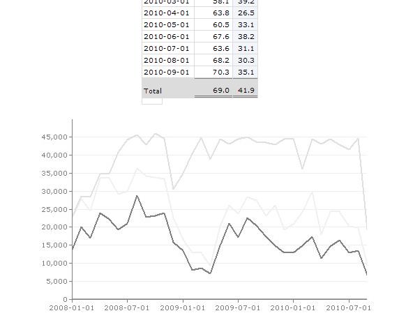

Postby shearerg » Tue Sep 14, 2010 5:42 am
I managed to obtain the graphs via a little fudge ... by dividing the unwanted data by 100000. This still (apparently) leaves enough precision to generate the calculations of interest, but greatly reduces their magnitude so that they no longer swamp the values of interest.
Works for me! Although a more configurable solution would be preferred :wink:
