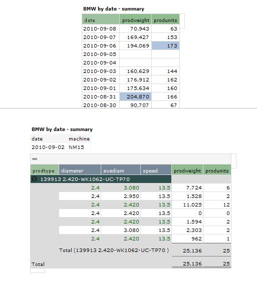

I have data recorded for machines which includes the product, date and shift details. I'm trying to construct a simple report which presents the data in various grouped stages, but I don't need to go to the individual record level.
I want to be able to say, for instance, accumulate to the date level effectively ignoring the shift indication. Unfortunately I can't figure out how to do this. Whatever I try, the final presentation always has a row representing each individual record. This is annoying, as the differences between individual records can be relatively insignificant, and just result in a fragmented presentation.
I hope I've explained this clearly enough. Perhaps a picture will help.
Hopefully you can tell me where I'm going wrong. But I will keep trying ...

I'm not sure I 100% understand the issue - but you can do 2 things:
1. Move details to "Own level" to avoid having the detailed records with your grouped aggregations (either through the drop down menu's, on the Group Tab in Ad-hoc or on the Group Tab in Design).
- or -
2. Not have details at all - by only having groups and totals and no columns selected for detail presentation
Sorry if I misunderstand!

Postby shearerg » Wed Sep 08, 2010 11:46 am
Suggestion 2 was what I was missing. I was getting a little confused, and hadn't considered the effect of having no details. The result is what I had in mind.
