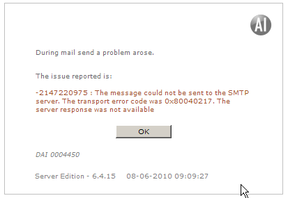

Postby Bob Cergol » Fri Aug 06, 2010 3:57 pm
I changed the server address to the one our IT manager would like me to use, where relaying is disabled and I added the SMTPUID and SMTPPSW parameters with appropriate values, and trying with and without the SMTPAuth / NTLM parameter, I get the following error when sending an email:
The same error info is captured in AI's log, but I want to remember the Agent program also writes an external log file, but I couldn't fine one -- so I'm thinking no further information was captured about the error.
Switching the server address back to the one where relaying is enabled -- and leaving the UID and PSW parameters in place, the email works.
Any ideas? Maybe its a port issue. I'm supposed to use port 587, but showing our IT manager this and mentioning that fact, didn't elicit feedback that port 25 is disabled.
Re: Email security options?
Postby Carsten Sørensen » Fri Aug 06, 2010 4:01 pm
Try setting: SMTPPORT
I'm pretty sure that it uses 25 when SMTPPORT isn't set.
Postby Bob Cergol » Fri Aug 06, 2010 4:23 pm
Explicity setting the port didn't work, but our system manager just informed me to use the same server I had been using all along and that the new server spec he'd given me only applied to client-side emailing that I use in my VDF applications.
All is working now with the authentication settings I added.
