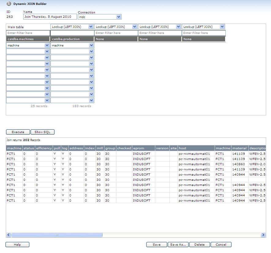

Dynamic Join
Symptom is that all goes fine during the design phase, but the ODBC driver returns an error when any other use is attempted. The first attachment (1 - Join design) shows a join description and data retrieved when it is executed. The second image (2 - Join error) shows the error returned when a browse is attempted using the join. On the face of it this looks like a deficiency with the database ... but in that case I'm puzzled at why the designed join executes OK?
1 - Join design.jpg (94.99 KiB) Viewed 215497 times
2 - Join error.jpg (28.01 KiB) Viewed 215497 times

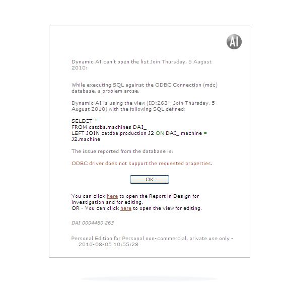

In fact, the only thing that doesn't work is when I try to browse or use the join in a report. All of the preceding steps behave as expected.
