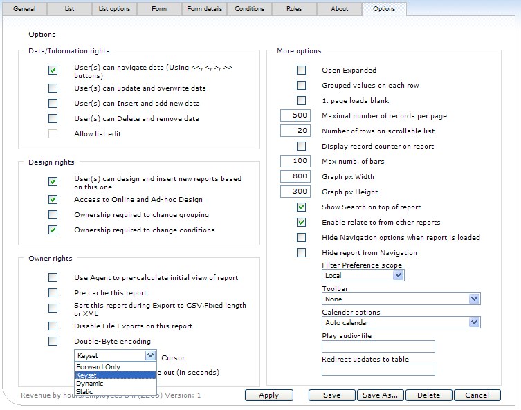

I think you are in the right direction with "cursors". We have had similar issues with Pervasive (as I remember it) in the past. What we were able to in that case was to set a different cursor on the Options Tab of the report (default is usually "dynamic" or "forward only") - maybe "Keyset" or "Static" would work with Ingres...

Thanks for the reply. And I must admit that it made me hopeful of a solution ... but unfortunately that doesn't seem to be the cause. I'm pretty sure the cursor setting you suggested is what I had been looking for but had been unable to find.
However, I've since tried all 4 possible options and none fix the problem, which is disappointing. I've also increased the row limit to 5000 with the same result, as it is a large potential data set. But the problem clearly isn't dependent on the number of rows initially returned.
