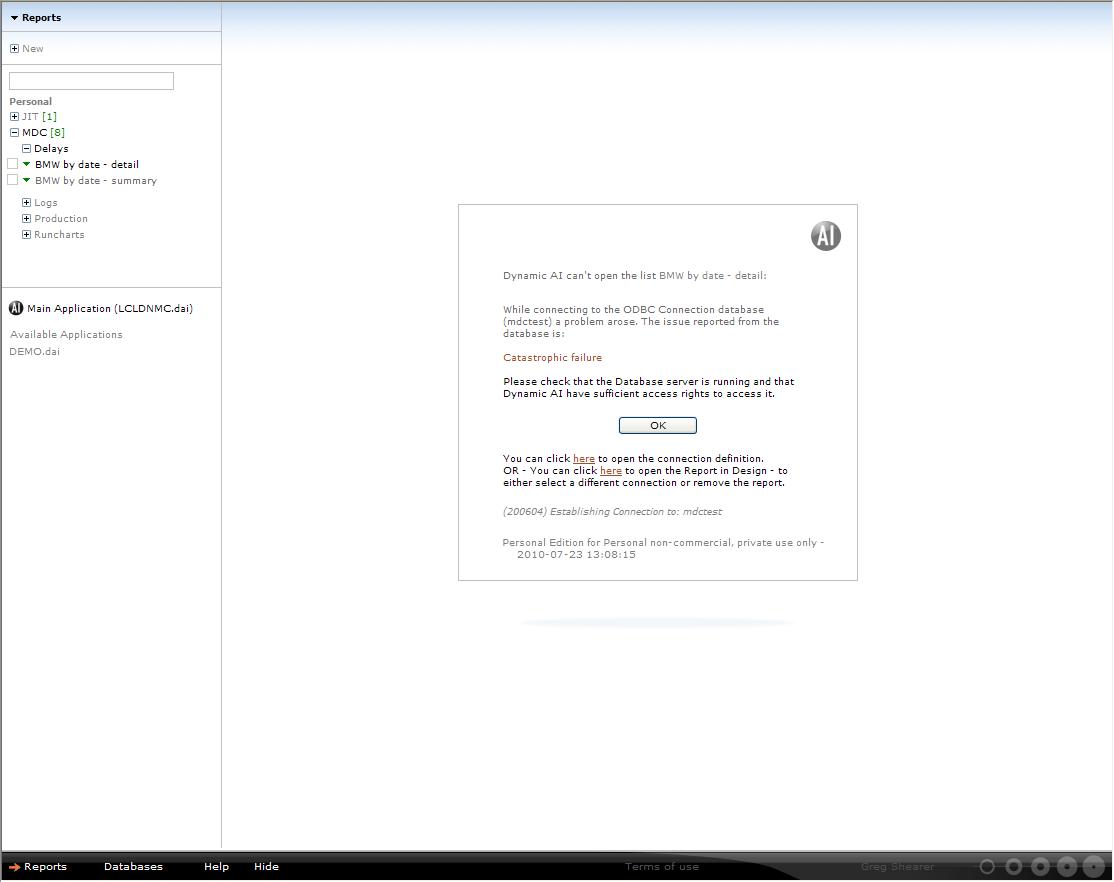

My problem is that when reports return more than 1000 data rows, attempting to retrieve the additional data crashes DAI. Following this I have been having to reboot my PC in order to get DAI working again. Despite error messages from DAI indicating a database problem, the database and ODBC connection to it continue to work fine with other applications.

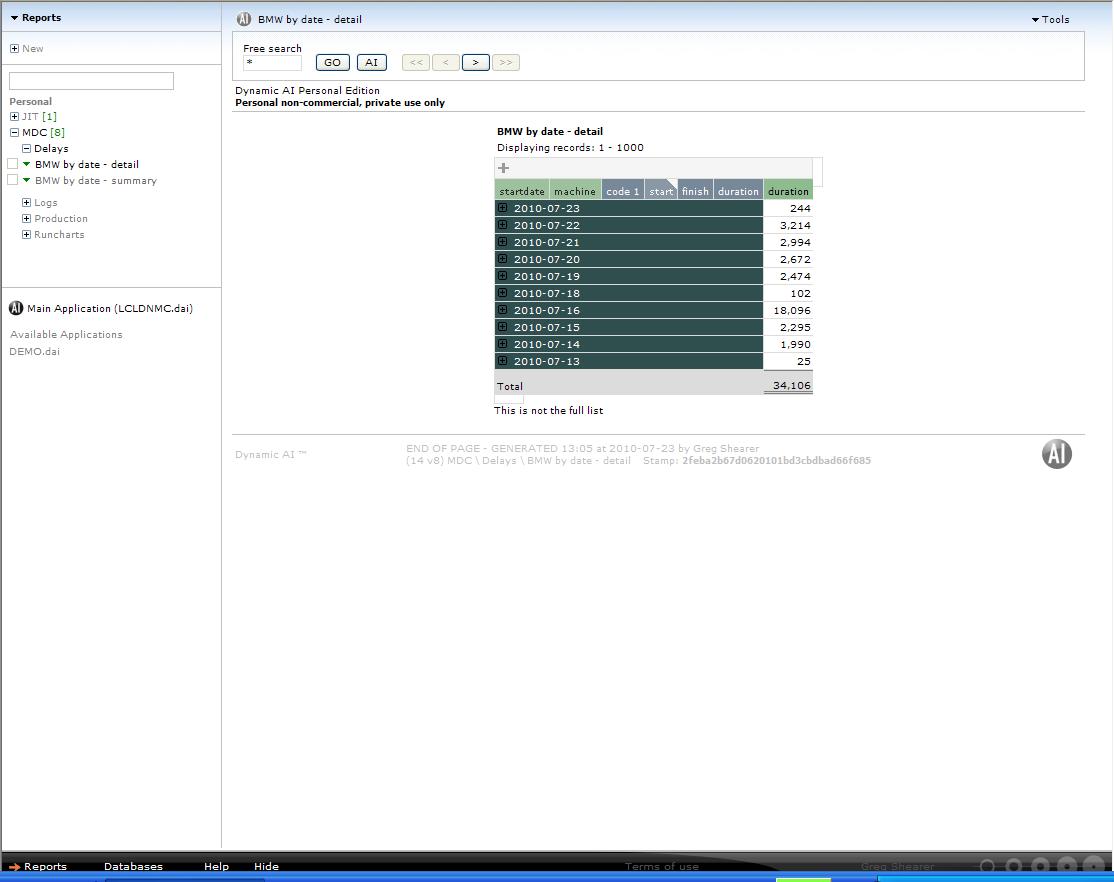

Some images are attached to illustrate the failure process.

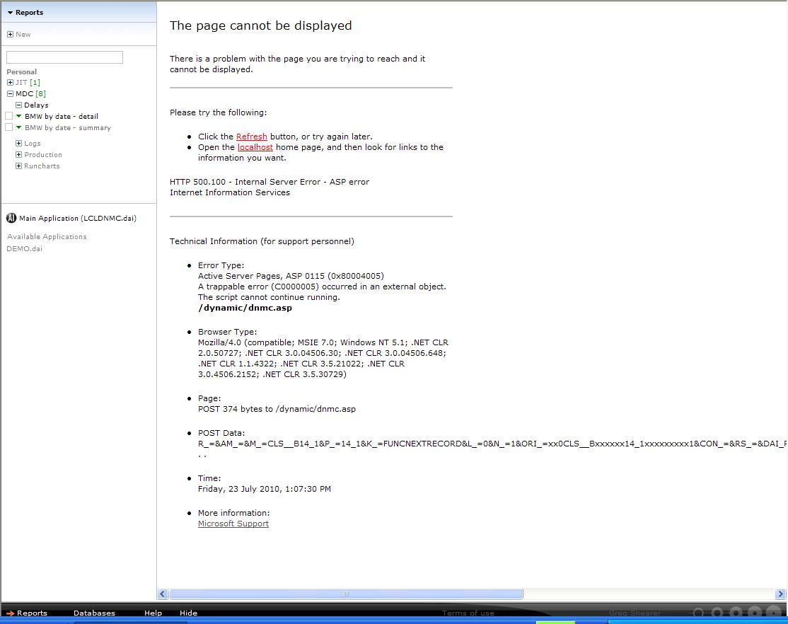

1 DAI - the initial successful data retrieval
2 DAI - what happens when the arrow is clicked to retrieve more data
3 DAI - what happens when you try to continue using DAI, although database is working fine ....
Attempt to retrieve more data
2 DAI.jpg (87.09 KiB) Viewed 19035 times
First retrieval
1 DAI.jpg (70.11 KiB) Viewed 19035 times

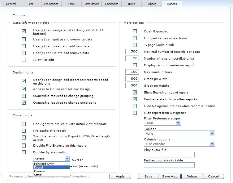

I think you are in the right direction with "cursors". We have had similar issues with Pervasive (as I remember it) in the past. What we were able to in that case was to set a different cursor on the Options Tab of the report (default is usually "dynamic" or "forward only") - maybe "Keyset" or "Static" would work with Ingres...

Thanks for the reply. And I must admit that it made me hopeful of a solution ... but unfortunately that doesn't seem to be the cause. I'm pretty sure the cursor setting you suggested is what I had been looking for but had been unable to find.
However, I've since tried all 4 possible options and none fix the problem, which is disappointing. I've also increased the row limit to 5000 with the same result, as it is a large potential data set. But the problem clearly isn't dependent on the number of rows initially returned.
