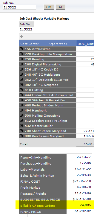

Report "Job Change Order Total" totals the price for all change orders selected for a single job number according to the supplied filter value. A key figure named 'Total Change Orders' is defined in this report based on the column total for [[Price_Est]].
Report "Job Cost Report" that also selects data based on a single job number value defines a key figure called: 'Billable Change Orders' and its formula is: [[//Total Change Orders@DAI:1846//]]
When I run the Job Cost Report it seems to display a consistent, random value for billable change orders. Consistent because its the same total no matter what job number I filter on; random because I don't know what set of records its reading to generate that number. For example running the change order report for job 215322 yields a total of 10,821.60. But the key figure in the job cost report for the same job number shows the total as $24,085.
Thinking the correct job numbe filter value was not being passed, I defined a relation between the two data sources used by these two reports on job number but that didn't make any difference.
Clearly I'm not fully understanding how cross report calculations are intended to be used or I am doing something wrong. I didn't find any mention of additional requirements in the docs.
