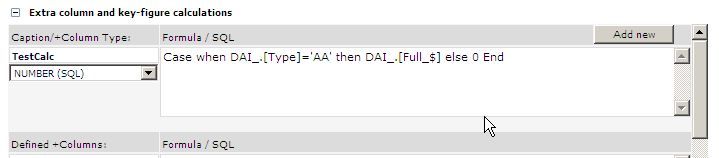

I've begun using key figure calculated columns recently and have encountered a problem: Once a key figure column exists, attempting to define any additional plus columns results in that new column's formula and data type reverting to type "key figure" with the formula of what ever happens to be the last key figure column in the list.
Here's a new plus column I'm about to add. I've copied the formula from another existing plus column to guarantee I've not made any typing mistakes.

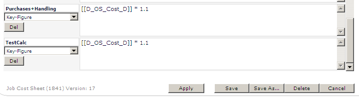

When I click the "add new" button, the page refreshes, and I find my newly added column at the bottom of the list as shown here.
I am using version 6.4.12 and have not defined key figures in previous versions so I can't say this behavior is new to this version.
The workaround is that I have to delete the key figures I've defined. Then I can add additional plus columns I need. Once I'm sure I have all those I need, then I can define my key figure columns. When adding a new key_figure column it will keep the formula I entered.

Re: side effect of existing key figure definitions
Postby Carsten Sørensen » Fri Jun 04, 2010 1:04 am
Thanks once again for reporting this - you are right that the bug occurs when a Keyfigure has been defined before the +Col type formulas. This happens in the Design List tab only - from the "point-and-click" interface you should be ok.
The bug is fixed and will be available shortly with the next build.
