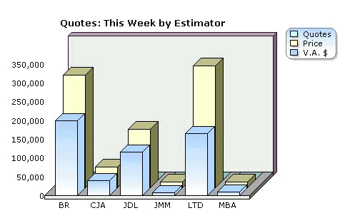

I would like to exclude certain report totals from graphs. For example a report might total:
Job Count
Price
Value Added
Value Added Pct.
Graphing Value Added Pct. is meaningless in a graph with Price since the scale then goes from less than 100 to hundreds of thousands. Or maybe I only want the graph to show Job Count and Price -- even though the other two numbers are desirable in the report.
Also, I want to control the sequence / position of the bars: for example I want the job count bars that are all shorter to appear in front of the very long price bars. In other words tall bars hide short bars.
I'm using BarV6 in this one example, but have tried many of the other formats and these sorts of issues can get even worse -- regardless of enlarging the size of the rendered graph.
Is there a way to accomplish either of these wishes?

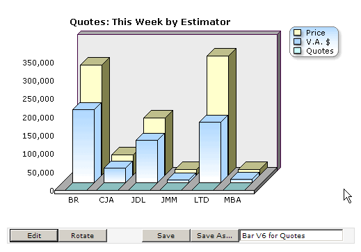

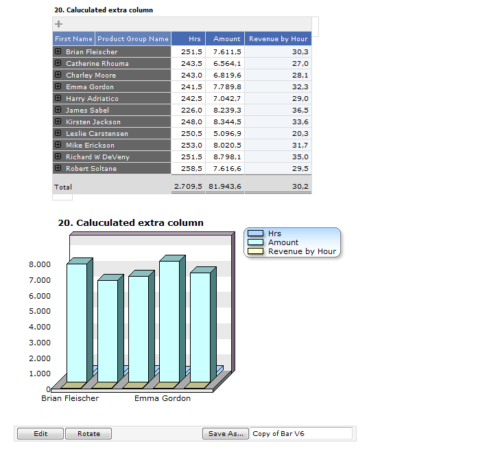

If I understand your questions your issue is a report looking a bit like this:
Initial report
First question is how to hide a column in the graph?

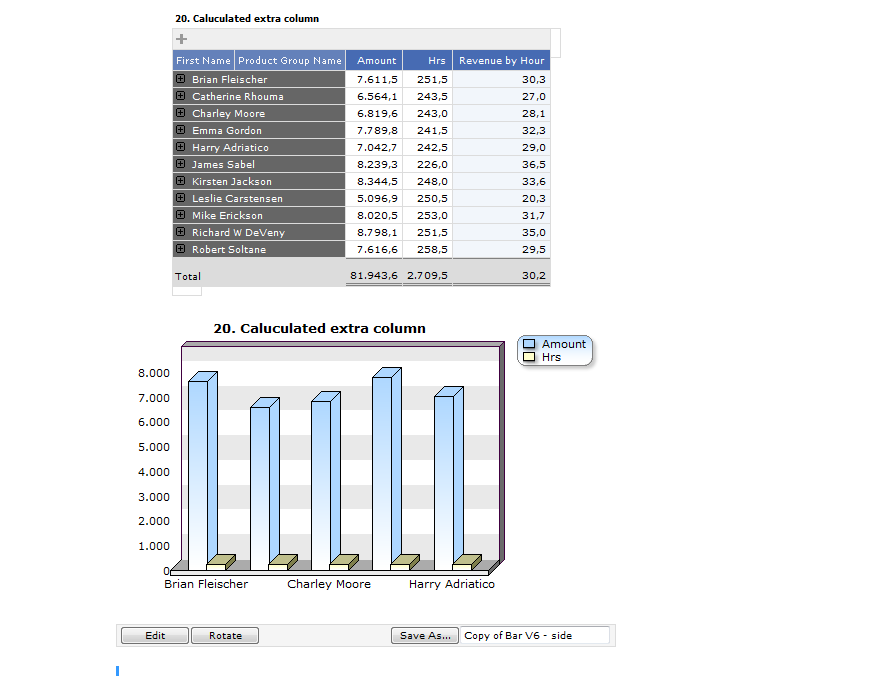

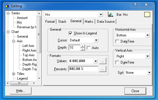

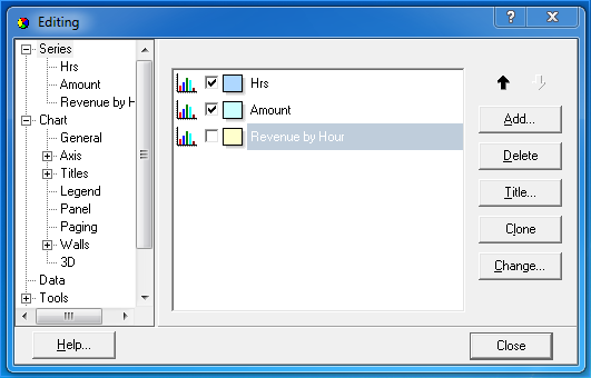

When running IE and having the graph shown via the ActiveX (set on the user profile) it is possible to modify and create new graph templates. This is done by clicking the Edit button below the graph.
The graph editor looks like:
Graph template editor
Uncheck the undesired serie and click Close.
It is now possible to save the graph as a new template. Change the name and click Save as.
Go to design and change the graph to the new template (found in the top of the drop down list).

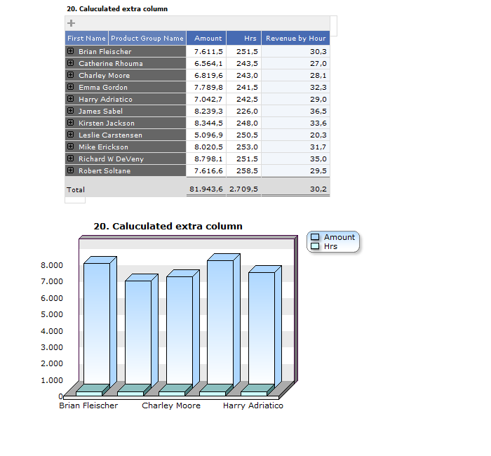

Changed graph template
Next question is how to change the order the series?

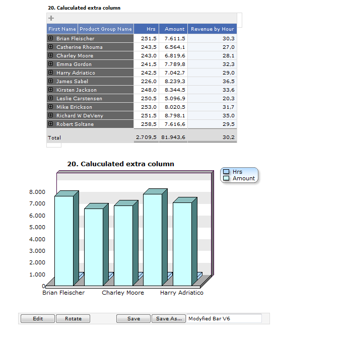

The order is following the order of the report. If you change the report the graph will follow:
Column moved which is reflected in the graph

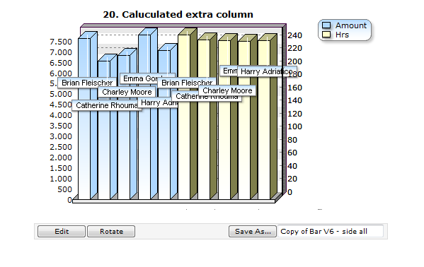

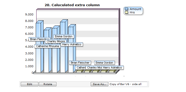

You can use a graph type where the bars are shown beside each other like
Bar by side
Or grouped by column:
Bar by side - grouped by column
Eventually you could modify the template to use 2 axis.
Change of the series axis definition
which could look like:
Bar using different axis
As you will discover in the graph template editor there are thousands of different ways to define your graphs. And all Dynamic AI graphs can be modified in order to fit the specific purpose.

The side-by-side bars with dual scales is a really nice solution -- but only for a small number of bars.
