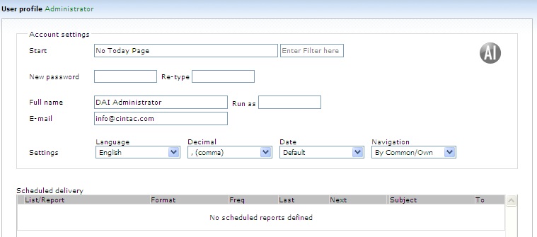

I have the option checked on the system security tab, but I just cannt find a menu option, button, or other object that allows me to "run as" another user.
How do I do this?
Re: Run-As another user feature
PostPosted: Fri Jan 08, 2010 3:58 pm
You do it from the User-Profile (click the username on the lower right corner of task bar).
Type in the userID and Save the profile.
Log entries will include the original UserID as well as the new run-as.
You need to have User maintenance rights to be able to "run as".
