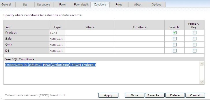

I'm not 100% sure where you would put the non-enforced alias - if you would put it in Free SQL Where - then you can already do it like:
Where you can also use GetDate() / Now and stuff like that. However that would be a fixed condition that the user can't change during execution of the report.

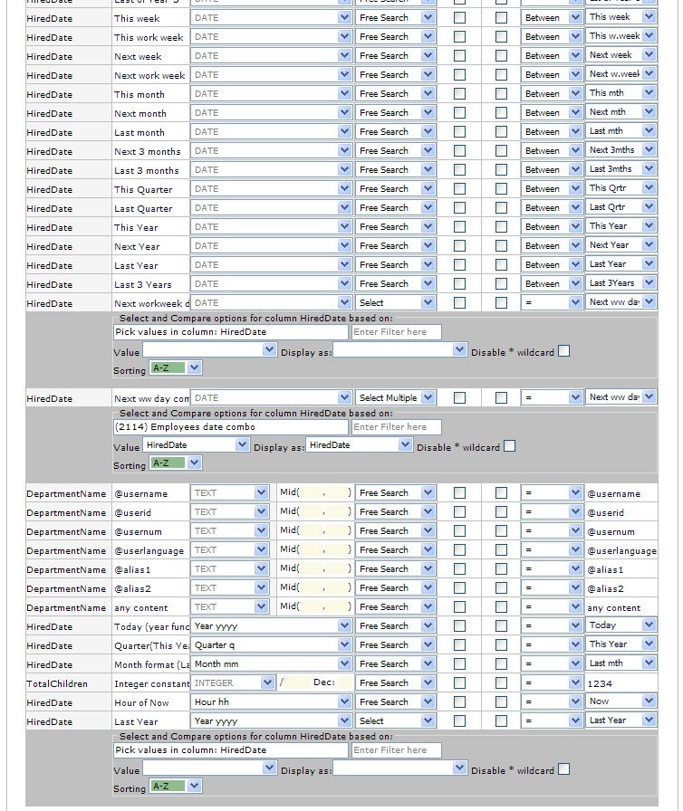

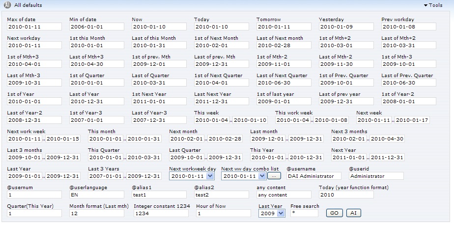

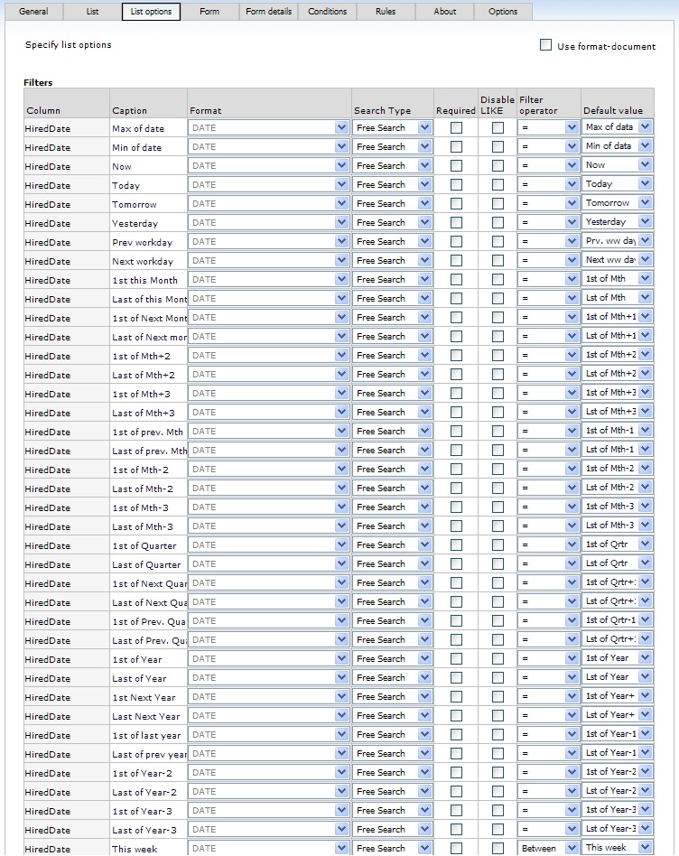

We have a lot of new default functions available for filters for the next release.
the definition:
Will be released soon.
