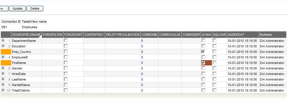

For the next release we have added a feature to mark columns that are AI N/A at dictionary level. Columns marked will not be considered for the sub-reports.
I realize that although it is easy to remove irrelvante sub-reports - at least in the situation where you apply AI to an existing report - for ad-hoc analyzing purposes - it could be helpful to be able to remove N/A columns - and in that case it can be done centrally using the dictionary instead of having to maintain each single report (see below).
