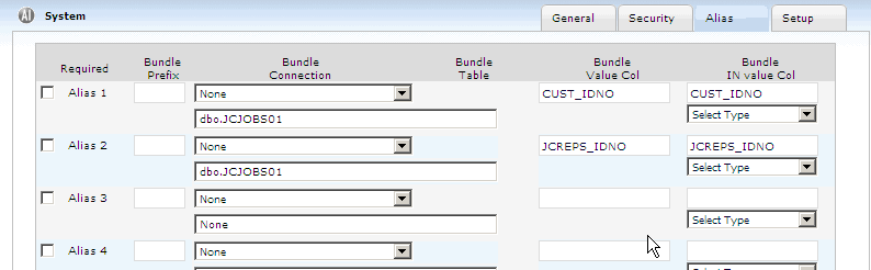

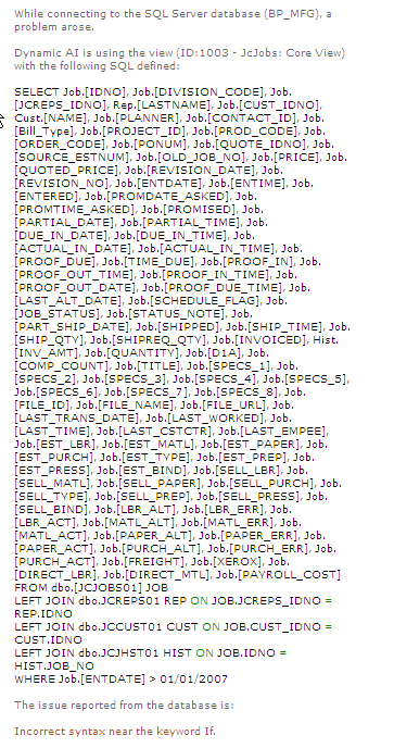

I have a DAI view that I can execute and browse the result set with no problem. But the report connected to that view gives a SQL error "Incorrect syntax near the keyword IF". That keyword does not occur in the view -- so DAI has to be generating it on-the-fly.
I had been muddling my way through setting up an alias1 filter on customer ID. I had that working fine. I could login as a user that had an alias1 value of "XYZ" and when browsing the view as that user, the result set was constrained to rows for "XYZ".
Thinking something I'd done wrong was causing the error, I removed the alias value definitions. However the system won't delete the system alias definitions -- and I'm thinking this has something to do with the error.
I've blanked out the values you see displayed, clicked save, get the system updated message, and then navigate back to this screen and the values are not gone. (BTW -- its tedious that navigation returns to the system start page after each update to any user or system data, and one has to navigate back to where one started.)
I admit I'm delving into this without having fully read the docs in this area and my understanding is still hazy so I'm probably doing something dumb.

Does the Dynamic AI View have a dictionary defined for it and/or a forced filter? Or maybe there was a filter put on the report itself? If it does have those, can you try to remove those and see if the error goes away?

I had defined a forced filter in the view's data dictionary, none in the report. After I proved that worked by browsing the view, I defined another one on sales rep ID and proceeded to work on a report.
After getting the error I thought getting rid of the filter and retesting was the right thing to try. Here's the sequence I followed as far as I can remember.
1) Navigated to Adm., System, Alias tab page and tried clearing the aliases show there.
2) removed all alias definitions from the user profiles
3) Navigated to Adm., Dictionary, Forced Filter/Key Fields, and deleted the entries from there.
After reading your reply I navigated navigated to the "maintain dictionary" option from right clicking on the view and clicked on the "enforced filters" tab, scrolled down and the Alias# values I'd entered are no longer there.
So currently no filters are defined. The view works, "AI" works on it, but the report generates the error.
I think I did something in an unusual, perhaps nonsensical sequence, and introduced some internal inconsistency. I'll delete the report and if that doesn't work I'll delete the view and start over. I am concerned that the system alias screen retains what looks to me to be incomplete entries.

When alias values are changed, these are not immediately active; they become active after logging out and in again. Could you try to logout and login to Dynamic AI to activate the alias values? That might help.

I deleted that report, recreated the enforced filter in the view and a new report and am not having any problem now. I' sure I did some convoluted sequence of things that you'd never be able to test that let to whatever went wrong.
