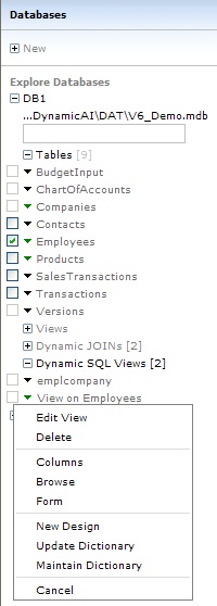

Postby Carsten Sørensen » Sun Jan 10, 2010 8:40 pm
For the new version we have completed the following new features for Dictionary inheritance:
1. When creating a dictionary for a Join-builder view - already entered captions on the underlying data-sources will be automatically cloned/copied to the join-builder dictionary entries.
2. When updating any dictionaries - multi-select checkboxes will be available for the DB explorer allowing to check which dictionaries should be inherited to the current / actual dictionary being updated.
example of dictionary caption inheritance. Captions entered on the Employees table will inherit to the view named View on Employees
