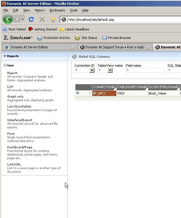

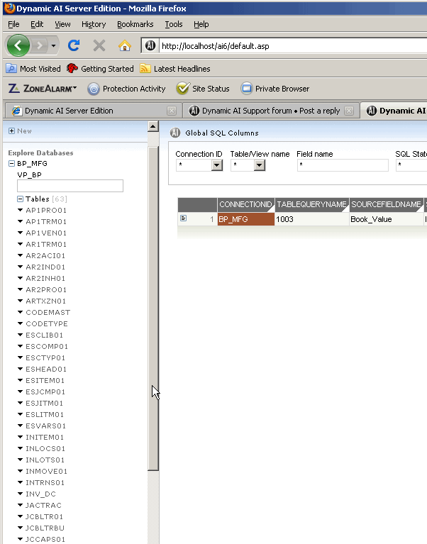

One place I found that misbehaves in fire-fox that an end-user would encounter is the slider bar in the left pane.
SliderBarBehavior_1.gif shows positioning the mouse getting ready to left click and slide the bar down.
SliderBarBehavior_2.gif shows the result as soon as you do that.

Re: Is FireFox fully supported?
Postby Carsten Sørensen » Fri Dec 18, 2009 8:50 pm
Bo was able to reproduce the behavior in newest versions of Firefox. What seems to happen is that Firefox now supports drag actions in this case the way that IE does - however with what looks like a bug in some cases.
To explain:
We have used the drag event to allow easy "swipping" (IPhone inspired I guess) between Reports and Database tabs without having to move the mouse-pointer to the bottom toolbar (lazy guys we are). It works flawless with IE. However I think we have had someone else in the past reporting the action as an error for IE as well - so I guess we better remove it - at least for Firefox - as it might be too "internal" and apparently now incompatible with Firefox.
