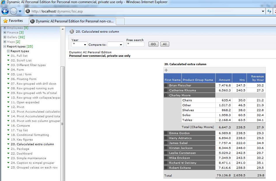

The best way to solve this is by calculating an extra column.
If you have the Dynamic AI Demo available you will find an example of this in the report group
Report Types / 20. Calculated Extra Column:
Screen shot 2009-12-08 at 11.37.25 AM.png (135.17 KiB) Viewed 42838 times

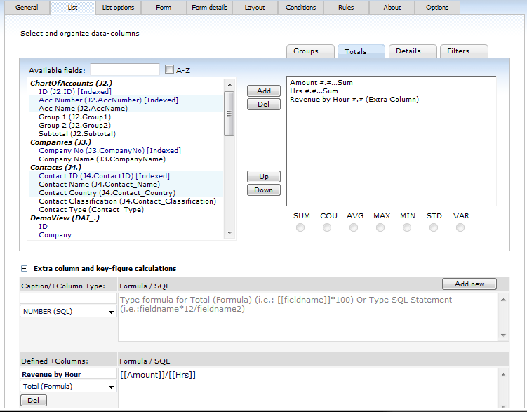

The Extra Column is defined on the List tab in design of the report:
Extra Column Definition
Screen shot 2009-12-08 at 12.18.35 PM.png (74.15 KiB) Viewed 42838 times
In your case the Total (Formula) should be defined as:
[[Margin]]/[[Revenue]]*100
After you have typed the formula click List tab, and you will see the new column appear as a Total.
Please be aware that the formula definition is case sensitive and can only be used on row-grouped reports.
The advantage of this type of calculation is that it's calculated on both details and group totals.

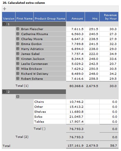

Regarding the use of extra columns and divide by zero:
Did you use the Total (Formula style) of +Columns?
When using this type, Dynamic AI should return '0' instead of an error as shown in the below example, where I removed the Condition set on [Version] and grouped by version as first row grouper.
Divide by zero in a Total (Formual) type of +Column
As you see the result is '0' where [Hrs] are null or 0.
If you still got trouble with this, you are more than welcome to send me screenshots showing the issues.
Also be aware that the main difference between a 'SQL' type and the 'Total' type is the time of the calculation. The 'SQL' type adds the sql statement to the original select and executes it, meaning that the average is calculated on transaction level. The 'Total' type is calculated after 'main report' preparation which gives you correct average calculation on the group levels as well.
