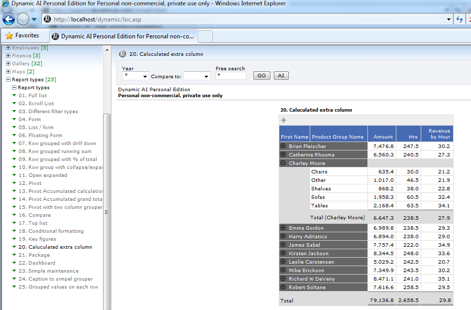

If you have the Dynamic AI Demo available you will find an example of this in the report group
Report Types / 20. Calculated Extra Column:
Screen shot 2009-12-08 at 11.37.25 AM.png (135.17 KiB) Viewed 42837 times

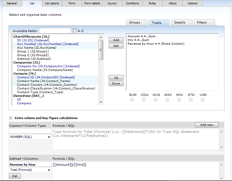

The Extra Column is defined on the List tab in design of the report:
Extra Column Definition
Screen shot 2009-12-08 at 12.18.35 PM.png (74.15 KiB) Viewed 42837 times
In your case the Total (Formula) should be defined as:
[[Margin]]/[[Revenue]]*100
After you have typed the formula click List tab, and you will see the new column appear as a Total.
Please be aware that the formula definition is case sensitive and can only be used on row-grouped reports.
The advantage of this type of calculation is that it's calculated on both details and group totals.

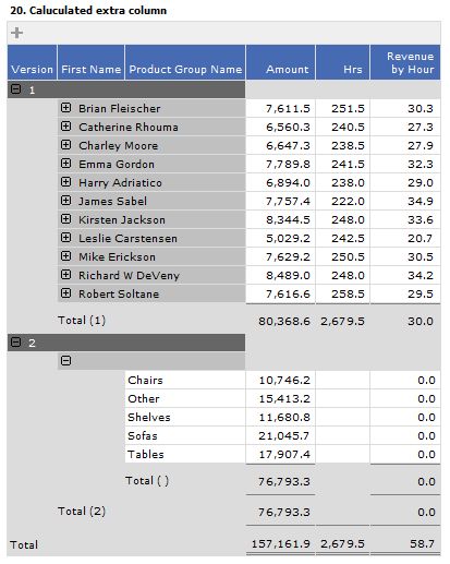

Regarding the use of extra columns and divide by zero:
Did you use the Total (Formula style) of +Columns?
When using this type, Dynamic AI should return '0' instead of an error as shown in the below example, where I removed the Condition set on [Version] and grouped by version as first row grouper.
Divide by zero in a Total (Formual) type of +Column
As you see the result is '0' where [Hrs] are null or 0.
If you still got trouble with this, you are more than welcome to send me screenshots showing the issues.
Also be aware that the main difference between a 'SQL' type and the 'Total' type is the time of the calculation. The 'SQL' type adds the sql statement to the original select and executes it, meaning that the average is calculated on transaction level. The 'Total' type is calculated after 'main report' preparation which gives you correct average calculation on the group levels as well.

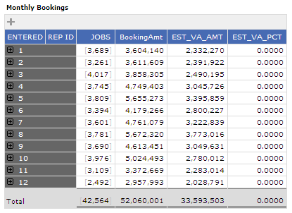

Postby Bob Cergol » Wed Dec 16, 2009 6:41 pm
Bo,
That's interesting. Adding the double brackets eliminates the error, and the column displays, but it doesn't seem to be calculating -- and I know the math is correct.
Formula for EST_VA_AMT = [PRICE] - ([SELL_MATL] + [SELL_PAPER] + [SELL_PURCH])
Formula for Est_VA_PCT = ([[PRICE]] - ([[SELL_MATL]] + [[SELL_PAPER]] + [[SELL_PURCH]])) / [[PRICE]] * 100
I also tried changing the formula to just: [[PRICE]] - ([[SELL_MATL]] + [[SELL_PAPER]] + [[SELL_PURCH]])
Still all zeros when it should be showing the same value as the Est_VA_Amt column.
Then I tried simply: [[PRICE]] -- still all zeros
Then I tried: [PRICE] -- all zeros, but no complaints about the field name without the extra brackets.
So it seems to not be seeing the data at all as a "+total column". Yet it sees the data as a "numeric SQL" formula column.
