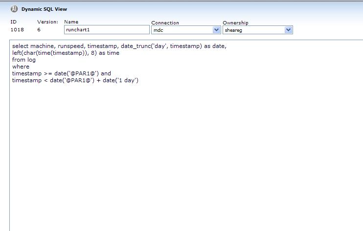

I've nearly been able to achieve what I want using a dynamic sql view with a date parameter, shown below. The only problem is that I can see no way of forcing the date parameter entry to be done via a date picker, which would be really, really nice! This is not a real show stopper, but easy date picking would be a real feature for a lot of applications I have in mind. I can arrange for a date picker to work OK when using a dynamic sql view ... but the limitation on depth of data availability means this approach won't generally be reliable.

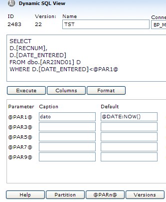

If you enter:
@DATE:NOW()
in the default for the @PAR, like:

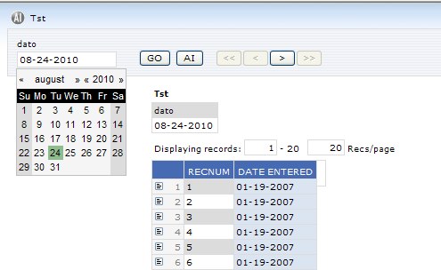

then it will tricker the date-picker:
