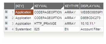

The Field Free 1 – 3 can be used for input of user attributes. Custom captions can be set by manipulating the System Text numbers, 853,854 and 855.
Alias captions 1-10 and e.g. Roles captions can be set in a similar fashion:
System text numbers are:
Alias1 825 Alias2 826 Alias3 827 Alias4 828

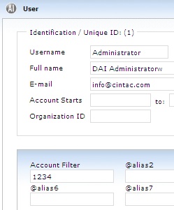

Regarding "system text" I was thinking I could make "Alias 1" display as "Account Filter" on all the user screens. I can't think of another purpose for being able to change the system text or caption -- assuming they are the same thing.

Changing the captions can be done like illustrated below.
