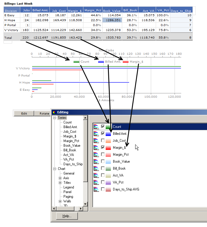

At this time you can't customize the interactive chart types -- the "HC" charts (High Charts) unless you learn Javascript and a lot of High Charts internals. Future versions of Dynamic AI will improve in this regard.
However, you can do very extensive customizations of the Tcharts. There isn't a tutorial on this -- but its not too hard to experiment. The attached is an example of intelligence showing 10 totals, of which only 3 are charted. To edit charts you have to have the "chart output" type in your user profile set to "TChart Active X". (Dan can do this for you.) Then when you hover your mouse over the chart or slightly below the "edit" buttons appear and expose the extensive design interface for the charts. You have to save your edits "as" a new chart type -- and then choose that chart for your report.
Alternatives to this would be building your report on an SQL view that can calculate your percent acknowledged but that gets complicated....
