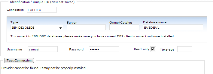

1. Using OLEDB :
At the first test connection attempt, I get no errors, only a "Processing..." message.
The seccond time I click the "Test connection" button I receive a the following error: "Provider cannot be found. It may not be properly installed." Please, see picture attached (OLEDB_2).
By the third time I click the "Test Connection" button, then I receive "Unspecified error".

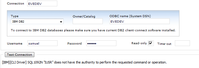

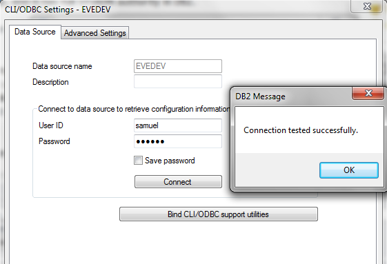

2. Using ODBC connection:
I have created and successfuly tested an ODBC connection to my DB2 local database. No error in ODBC Layer. (Look the second picture attached, ODBC_Test).
This time I get the error: "[IBM][CLI Driver] SQL1092N "IUSR" does not have the authority to perform the requested command or operation. "
Please see attachement ODBC_Error.
I have granted IUSR user the most privilege I can, what else is needed.. and why Dynamic is using IUSR (iis user) to conncet to database instead of the user I have supplied in the connection window... ?

Were you able to resolve this in the meantime? I'm pretty sure it is a machinename_IUSR rights issue related to the DB2 drivers / OLEDB/ODBC...
To answer your question regarding why Dynamic AI is using the IUSR instead of the database user... - Dynamic AI use the IUSR rights to initiate the connection to the database and use the DB user/assigned DB user-rights to connect to the database. IUSR is the the web-service user and DB user is the database user. In principle we could have a IUSR account in all databases or you could have all needed DB users added as web-service user accounts. In either case you would have to do some additional user rights maintenance. With the current IUSR / DB user rights distribution you - in most cases - don't have to do anything specific for Dynamic AI to function as the IUSR is setup to give you all needed web-services access and whatever existing DB user that you connect with will work underneath that context.

Yes, I was able to fix that. Sorry for taking so long to answer.
I have granted IUSR user connect privilege to database.
But I don't know somehow, It was not working anyway in the same momment I have installed DAI.
It only worked properly, for both errors (ODBC and OLEDB), after I rebooted my machine.
Thanks very much!
