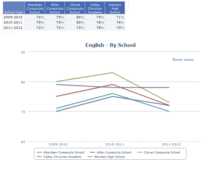

I have created a report which shows average grade mark for a specific subject for schools for previous school years. The report has a single filter where you can select a single school or multiple schools so you can compare them to each other. The problem I am running into is that when I select multiple schools, the graph can be a bit messy looking with the selected schools scoring similar grades. I would like to add a legend and have each series be a different color so it is easier to distinguish on the chart. I have gone into the Rules tab and added the javascript to enable legend but when I run the report, the legend still does not show up.

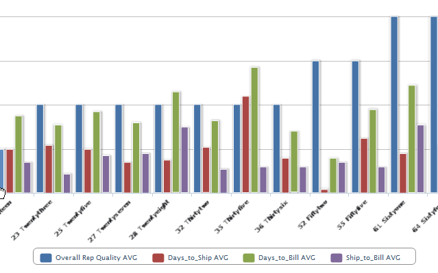

When the conditional formatting was enhanced to work with with multiple totals having different magnitudes, and then when this was enhanced to extend to charts -- replacing the default colors in the chart with just the 3 colors defined by the conditional value thresholds -- created a problem.

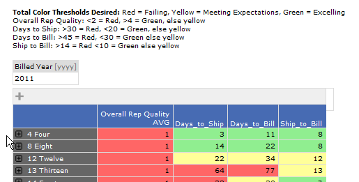

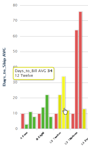

The issue was what to do with the legend. Since colors no longer equated to named totals, but instead to value-based thresholds, the legend made no sense. I voiced the opinion that: "I think the report itself is sufficient as the legend -- besides hovering the mouse over the bars displays the total. In a chart-only presentation not naming the value ranges would be more an issue. I do think it is important to hide the default legend when the colors are controlled by a value range. It will be confusing to a user to see the legend when it doesn't correlate with the actual graph. "
I think these screen shots illustrate the issue and why the lengend was hidden. When a single total can be anyone of 3 different colors -- how can you show a color legend?

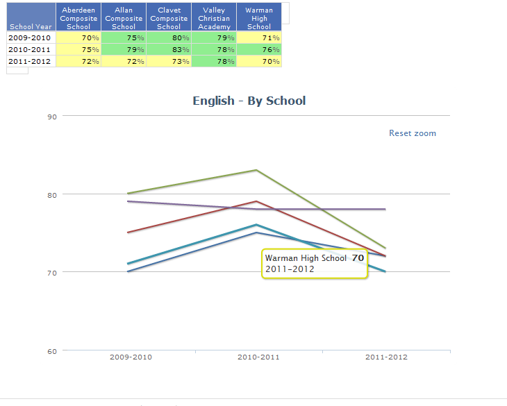

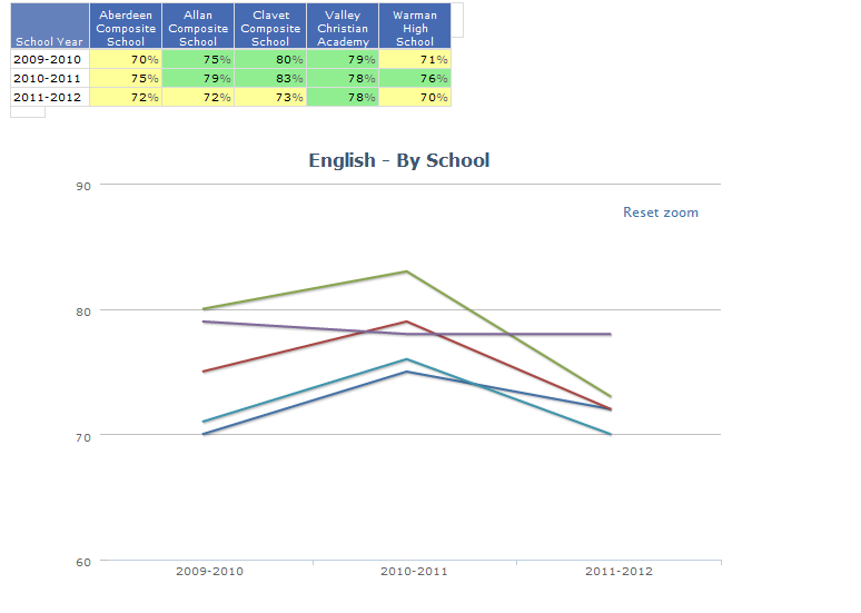

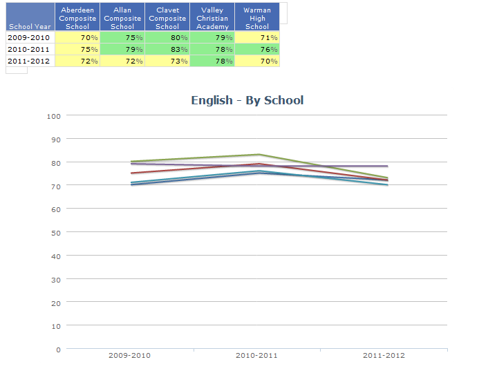

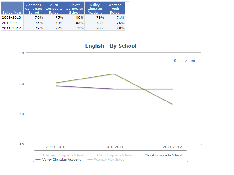

I see what you are saying. Here is a possible situation where a legend would be helpful to have. Attached are 2 screen shots of a report and chart I have created showing average English grades for 5 of our schools (I specifically filtered for these 5 schools). The first chart is the default view. The second view is the same chart except I have zoomed in to get a better look and distinguish the lines better. If all the schools have the same or very similar grades, on the default view the lines are too close to each other which is why I enabled zooming so when I hover my mouse over a line I can see for which school it is. The possible scenario that could come up after zooming in is I now want to see 2 of the 5 schools on the graph on this zoomed in view. If the legend was present, I simply click on the schools I don't want to show on the graph right on the legend and that data is no longer shown on the graph. Without the legend, I have to run the report again by choosing the 2 schools desired in the filter which would reset my view of the chart again.

Postby cavillafuerte » Wed Mar 14, 2012 5:00 pm
Previous post didn't allow me to upload 4th screenshot so here it is.

For my report, the table visually shows whether a school is below adequate, adequate or excelling based on the color of the cell. On the chart, the lines are a single color representing the school regardless of the colors of the cells for that particular school. If I hover my mouse over a point for the school, the tooltip box displays the total and the color that is associated with that cell. In my screen shot, you can see Warman High having 2 totals in yellow and 1 in green. The line on the chart for this school is blue but when I hover over point for 2011-2012 you can see the total of 70% in a yellow box which is the color being used in the table. Another issue with my report would be if I wanted to print off the report on a color printer, without the legend it could be difficult to distinguish what the graph is displaying without the legend. Within DAI I can hover over a line and see what school that line is.

Sorry, forgot to answer your last comment about relying on the filter. Using the filter is an option however, if I am working on the results for only the filtered 5 schools in my example and I temporarily want to view 2 of those 5 schools on the graph, using the filter would remove the results of the other 3 schools from the table and the zoom view is also reset. The reason I would like to keep the results up on all the schools is the end user could be in charge of a number of schools, in my example I have 5 schools. I could notice that 2 schools seem to be struggling so I would want to display these 2 schools on the graph only but keep the table with all the schools I am in charge of.
