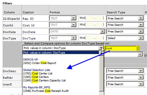

Regarding combo-form filters, I think the 500 limit is hard coded -- but I also want to remember you could get around it by making your own list report and pointing the filter toward using it on the list options for filters -- and then in that "selection" list report setting the maximum rows per page to a higher number. I know I found a way to do this once, a long time ago, but abandoned it since such a long list seemed impractical and not very user friendly -- not to mention the behavior in the filter drop down lists are not searchable and the user has to scroll, and scroll ...

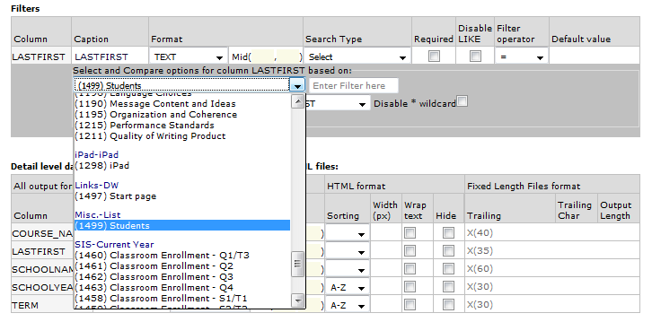

I have created a list with all the names of the students. Under the list options tab for the report I want to apply the filter I have chosen this list for the Select and Compare options. When I run the report, the select list now shows all the students and not just the first 500 which is great however, when I choose a student from the list, it doesn't apply that filter to the report. What else could I be doing wrong?

I'm not sure I'm clear on what you've done, but on the list tab options page the filter box I think you are referring to is only for helping to find the target list you want to use as the list for the comboform.
I think I was suggesting you could use an enforced filter on the list report being used for the comboform filter.

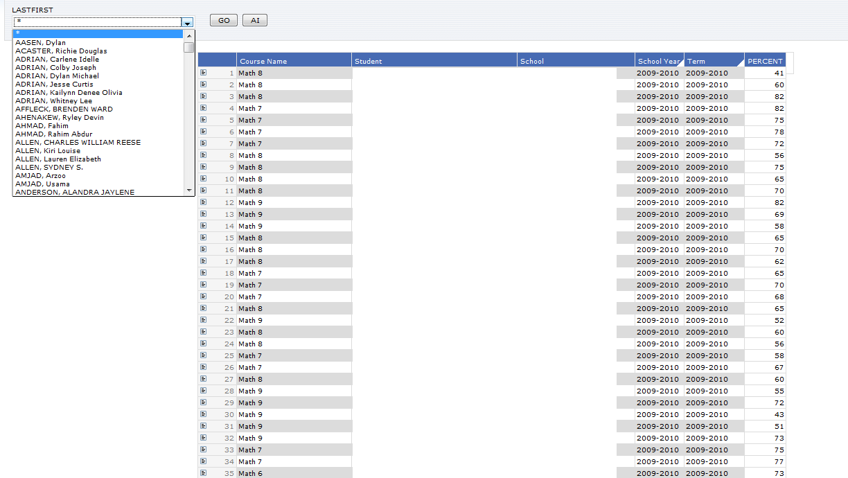

Postby cavillafuerte » Tue Mar 06, 2012 8:50 pm
I have attached a screenshot.
I created a list which shows all students. I selected this list to populate the Select list filter box
and this works just fine as you can see and doesn't limit my list to 500.
but when I select a student from the list and click on go, it doesn't filter for the student selected.

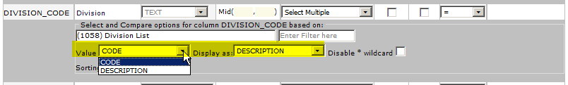

Is the column from your filter list that you have set as the Value defined the same, and containing matching values to, the column used by the filter in your report?

Postby cavillafuerte » Tue Mar 06, 2012 11:29 pm
I got it to work. I had to add an extra column to both the list and the report (studentnumber) set that to the value and it now works.
